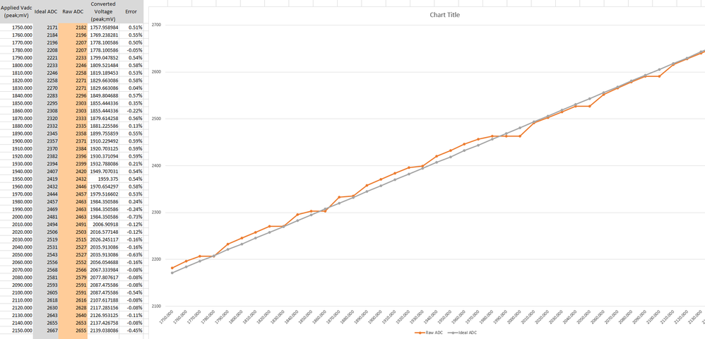

I measured ACD input increasing the voltage by 10mVdc. but, there are non-nonlinear points.

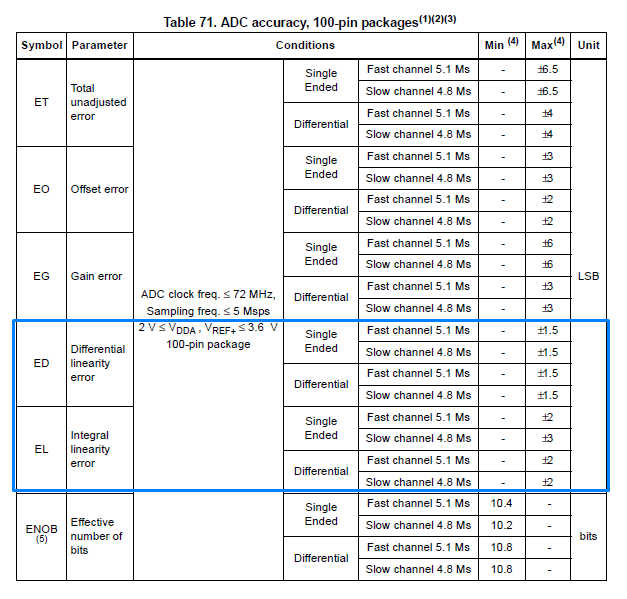

As the datasheet, ED and EL are +-1.5LSB and +_2LSB. It seems that my measurement result is bigger than them.
Could you please explain how to reduce the error?

Have you checked that your test conditions (electrical and software settings like sample time) match those stated in the datasheet you cited ?
2017-11-27 5:26 PM
I think below my condition was satisfied with those test condition on the table.

The PCB design / layout has a significant influence, as have the tolerence and impedance of your (reference) input voltage source.
If you think some STM32 MCUs have a problem with the ADC peripheral, better discuss it with a ST FAE.
Most people here, like me, are users, and need to rely on the same documentation as you.
And the ST people present here are rarely hardware experts.
