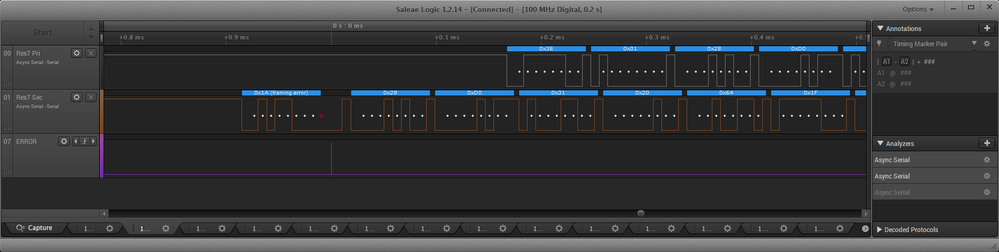

I am using NUCLEO 446 RE board. I am using the HSE from the STLINK.
All the devices are sending the same frames at 125Kbaud.
i have checked the errors with a logic analyzer.
my logic analyzer sees the same framing errors when it tries to decode the frames.
When i check manually and automatically (logic analyzer), the baud rate is fine.
The framing errors are always at the beginning of each message 99% of the time.
Third trace purple is when i get the FE error interrupt.
First trace is good.
Second trace is missing about half of the 0x3E, 0x01 header,
The balance of message is synchronized.
I ran for days with the other two version of the device with no errors or issues.
Today i added tried the remaining device flavour and the errors occur.
I have tried 3 different unit of this version. The all have the same framing issue.
Pretty sure the issue is the one device variant.
Errors occur about once every 20s (about every 2000 messages or 88000 bytes)
And i am just going to have to figure out how to negotiate the errors.
