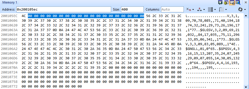

Hi, I have the below code where I trigger the UART DMA and write to a buffer, and in the while loop I simply do a read from the buffer 1st element:
MX_UART7_Init();
Uartret = HAL_UART_Receive_DMA(&huart7, uartbuf, 300);
while(1){
if(Uartret == HAL_OK)
timeBuf[0] = uartbuf[0];
}here is the uartbuf:
however if I remover the read line the 00s are will with values which I am expected.
Is there a way to read from dma on the fly ?

stm32f73x, if i make a loop to read I can see more zeros.
2020-07-08 9:33 PM
Where do you see zeros? In the debugger? Isn't that a debugger artefact, i.e. does the program in processor see those zeros? Isn't there some other process running which would write them?
Write a minimal program, which only starts the USART DMA and then goes to an infinite loop (i.e. does nothing), observe. Instead of continuously transmitting device, connect UART to PC and transmit into it manually, character by character, and observe.
