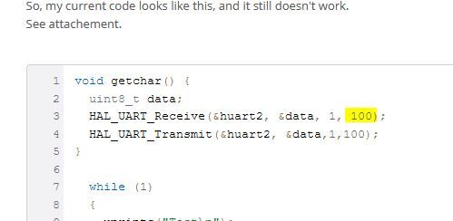

So, my current code looks like this, and it still doesn't work.
See attachement.
void getchar() {
uint8_t data;
HAL_UART_Receive(&huart2, &data, 1, 100);
HAL_UART_Transmit(&huart2, &data,1,100);
while (1)
uprints("Test\n");
getchar();

ocourse will not work if wait only 100msec to get a character from your keyboard. Increase the read timeout to max
Blocking is the function(this purpose) that doesn't return before timeout or finish the transactions
