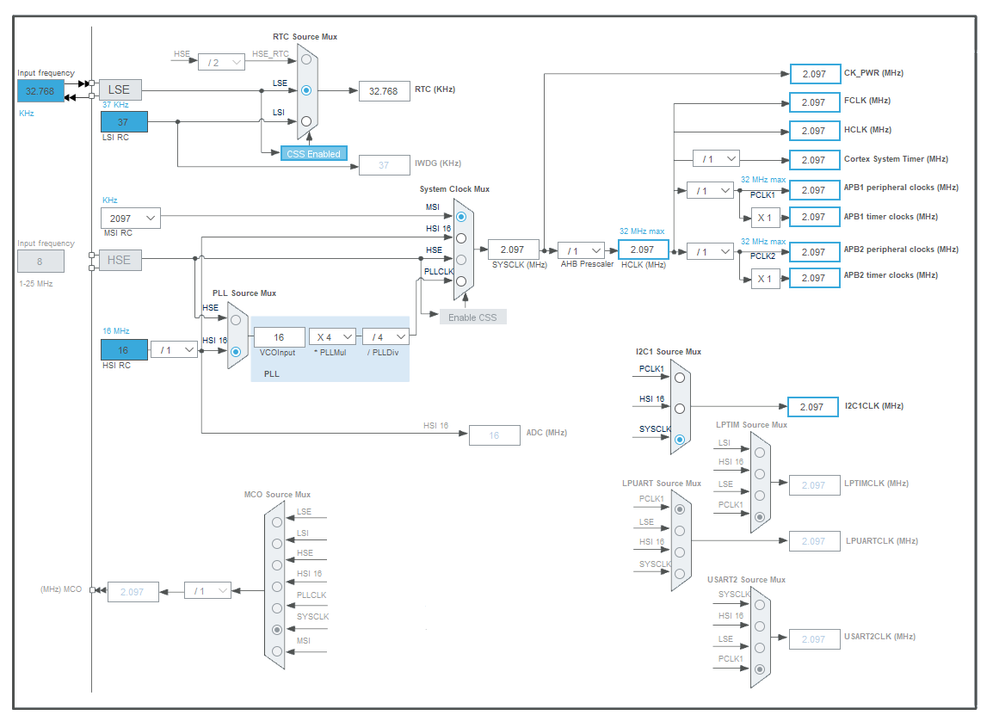

These are the clock settings

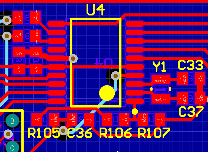

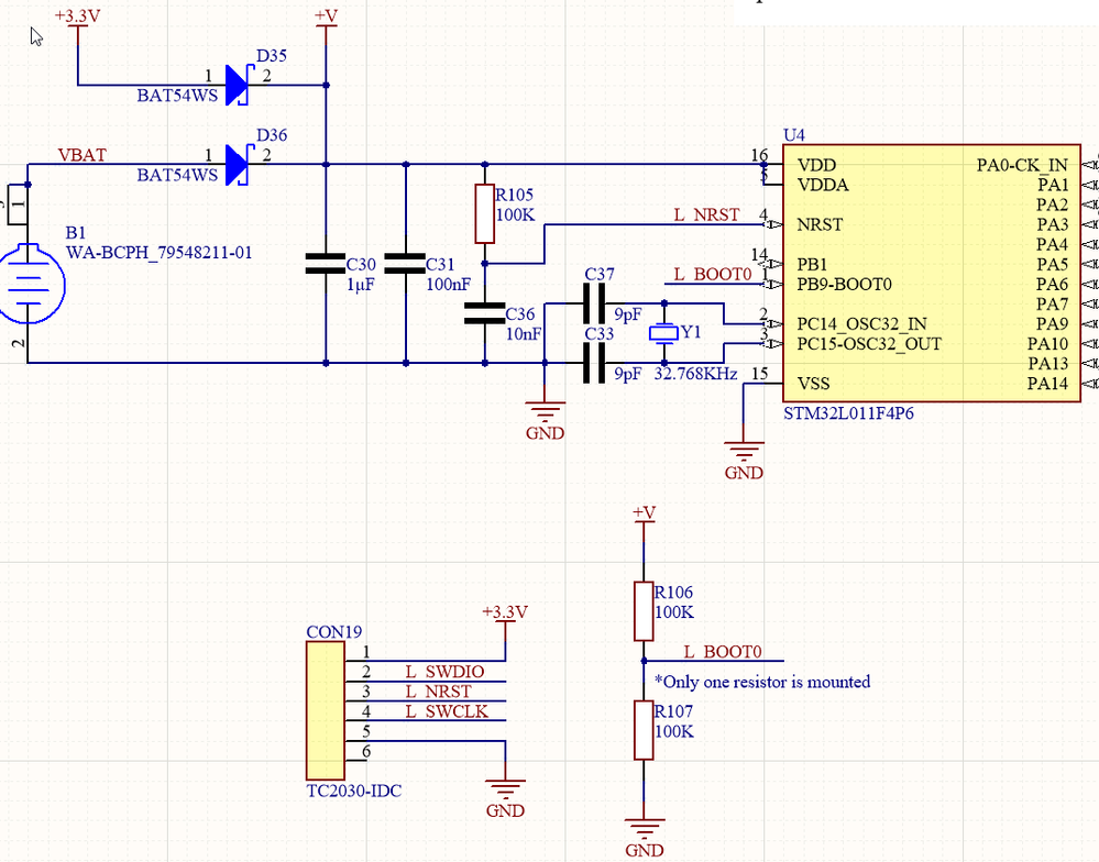

The crystal is recommended by STM, and the PCB seems ok.

Also, you cannot measure directly on the LSE pins/crystal, as it's a ultralow-power circuit and your oscilloscope probe is too much of a load so it simply "chokes" it. Unless you are specially equipped for this (using ultralow-impedance active proble) LSE is to be measured indirectly, by outputting it to some pin through the STM32 - but in the low-pin-count package this may be a challenge.
