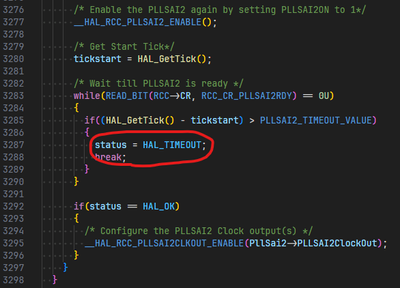

I'm using a STM32L476 and the HAL from ST tag: v1.12.0 and it appears in some cases that when I'm configuring the PLL for the SAI2 peripheral that the RCC_CR_PLLSAI2RDY flag from the RCC->CR register is not ready.
Did anyone had the same issue? What could cause this?
