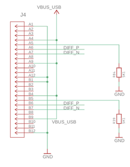

The hardware is as follows (USB Type-C):
Unfortunately, I did not design it, and I currently cannot modify it.

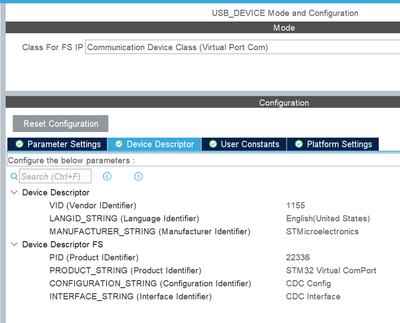

The firmware configuration is as follows:
with USB, UCPD1 and UCPD2 global interrupts enabled.

Yes, the CRS SYNC is configured as CRS SYNC Source USB. I forgot to insert the screenshot of this in the first question...but the problem remain.
