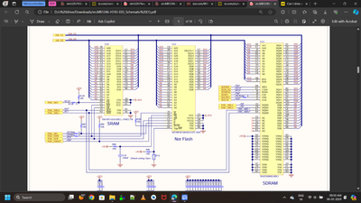

I noticed in the EVL-SCH that SDRAM, NOR flash, and SRAM are connected to D[0..31]. I'm unsure why they are connected this way, and I'm wondering if I need to use these memory components as they are not present on discovery boards (specifically NOR flash and SRAM)

As said by @LCE A[n] and D[m] refer respectively to FMC_A[n] and FMC_D[m]. Refer to the datasheet to check the correspondence GPIO pin / FMC alternate function.

D[n] / A[n] here are not the STM32's PORTD / PORTA, but simply the memories' data and address lines.
