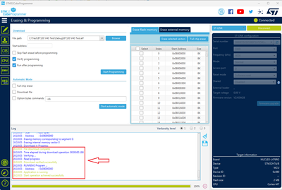

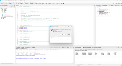

I solved this problem. I changed the file name from "startup_stm32h7b3lıhxq.s" to "startup_stm32h7b3lihxq.s". But I encountered a new problem. The problem is that there is no "FLASH.Id" file in the projects I created with cubemx and I have to manually copy this file into the project folder each time. Finally, I compile the project without any problems, but I cannot debug it. I programmed the MCU with "STMCubeProgrammer". But I cannot program with Cube IDE.

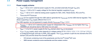

Hi guys.
I will explain the details of the solution to a problem that I encountered while working on the project and that many people have experienced but could not find a solution to. Some pins in this MCU cannot be used. Many people on the internet have experienced problems where they cannot use port B. The main reason for this problem is that some pins are connected to a secondary power supply. In the MCU I am using (STM32H7B3LIHQ), PB8 - PB9 - PD6 - PD7 - PG9 - PG10 - PG11 - PG12 - PG13 and PG14 pins are connected to the secondary power supply.
These pins are powered by "VDDMMC". When designing the schematic and PCB, I used the "MB1331" reference design and the "STM32H7B3I-EVAL" board. On this eval board, the "VDDMMC" pin is connected to the uSD2 card via the SB14 jumper.As I was not using a uSD card, I connected this pin to ground with a capacitor and left it unused. As a result, the pins connected to this power supply did not work. It is clearly stated in the datasheet that if this pin is not used, it should be connected to the VDD pin.
In summary, for the I/Os connected to the "VDDMMC" supply to work, the "VDDMMC" pin must be connected to VDD.
