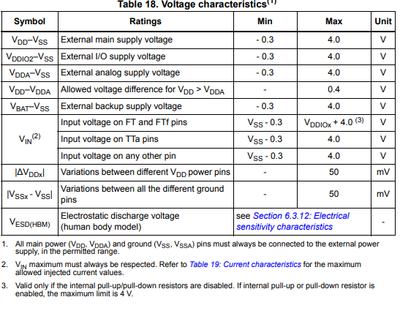

I have VD VDDA Vddio2 are same voltage so i think that have respect table 18.
For input voltage i have 5v on the gpio FT so if i understand the maxim volge on FT pin is VDDIO2+4=3,3+4=7 V (I DONT HAVE INTERNALL pull-up/pull-down)
For the the maximum allowed injected current values i dont understand the table 19 my conditon is this :
VIN =5 VDDIO2 =3,3 V so i have VIN > VDIDDO2 ( positive injection)
the table 19 if i understand give me a current positive injextion 0 mA , seem that dont have problem VIN =5V , it is right or i must use voltage traslator ?
