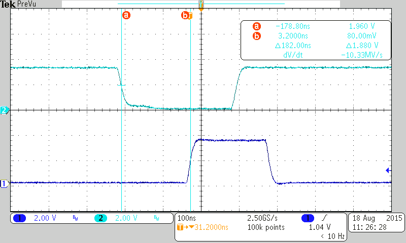

No, i mean HSYC is falling indicating blanking, at this moment that is 300ns long. So i must disable DMA, reconfigure DMA with new address and and enable DMA, so it will fill new line to SRAM as it should
Right now my interrupt takes 200ns, but it is shifted by 200ns, because it takes time for CPU to go into interruptvoid EXTI4_IRQHandler(void)

With only interrupt code running, i have around 100ns free time before HSYNC goes high. only few numbers needs to be written to DMA registers, clearly, it could be done faster than 100ns ?
And i am running at 218MHz clock speed, because any lower, and i will massive errors with DMA buffer. PCLK is 53.3333MHz I wish i could use STM32F7, but no one can help me with code, and i spend so much time, that makes me sick trying to go back to STM32F7 (only DCMI, and SPI_DMA in circular parts is not working, so close, but so far at the same moment)We’re moving the ST Community to a new platform to give you a better and more reliable community experience.
