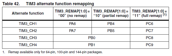

What is the difference between GPIO_PartialRemap_TIM3 and GPIO_FullRemap_TIM3 as used in the GPIO_PinRemapConfig() call?
2013-09-03 1:46 PM
Two vs Four channels?
2013-09-03 2:46 PM
Ahh! I searched the forum and google'd but I never thought to look in the datasheet. Doh!
Thank you, Clive! If one uses Full remap but PC6 is not set to Alternate Function, will PC6 still function as a general purpose I/O pin?2013-09-03 5:40 PM
Yes PC6 can remain as a GPIO, as can any channels you are not using, or ones which you are only using internally.
