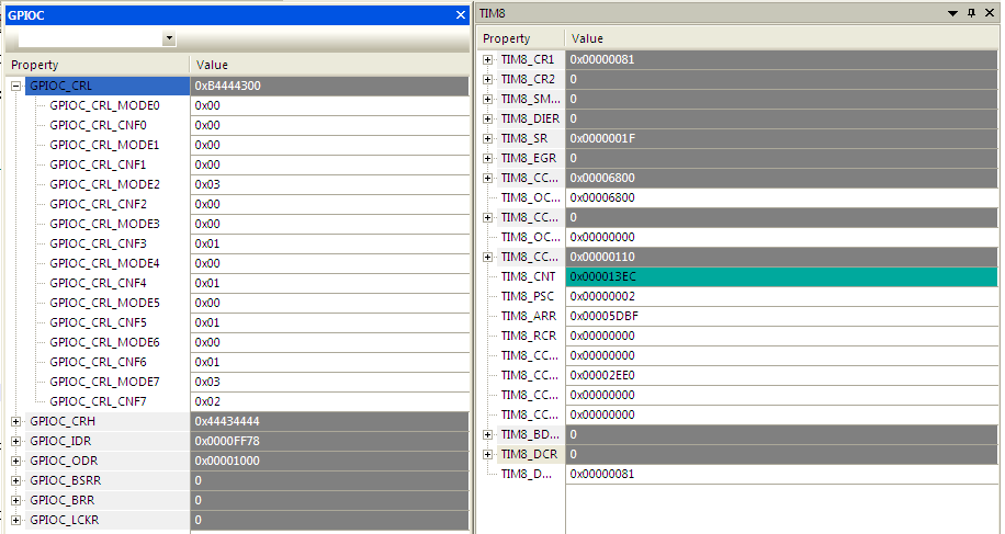

It looks like the counter and the reloading is working just great from the Keil uVision tools. However, it looks like TIM8_CH2 is not connected to the actual pin (PC7).
How could I trace if the pin (PC7) is getting connected to TIM8_CH2. I can see that if I use PC7 as standard GPIO output pin I can toggle it easily. For some reason the mapping that connects TIM8_CH2 to PC7 is missing. I don't see anything obvious, but it might seem to be something in AFIO. I have already enabled the AFIO clock. The register values are the following:2011-05-17 5:14 AM

Can you help me?
The Timer 8 is not running. the TIM8_CNT not count...
[DEAD LINK /public/STe2ecommunities/mcu/Lists/ARM%20CortexM3%20STM32/Flat.aspx?RootFolder=/public/STe2ecommunities/mcu/Lists/ARM CortexM3 STM32/Timer 8 not working STM32103RD&FolderCTID=0x01200200770978C69A1141439FE559EB459D758000626BE2B829C32145B9EB5739142DC17E&TopicsView=https://my.st.com/public/STe2ecommunities/mcu/Lists/ARM%2520CortexM3%2520STM32/AllItems.aspx¤tviews=33]https://my.st.com/public/STe2ecommunities/mcu/Lists/ARM%20CortexM3%20STM32/Flat.aspx?RootFolder=%2fpublic%2fSTe2ecommunities%2fmcu%2fLists%2fARM%20CortexM3%20STM32%2fTimer%208%20not%20working%20STM32103RD&FolderCTID=0x01200200770978C69A1141439FE559EB459D758000626BE2B829C32145B9EB5739142DC17E&TopicsView=https%3A%2F%2Fmy%2Est%2Ecom%2Fpublic%2FSTe2ecommunities%2Fmcu%2FLists%2FARM%2520CortexM3%2520STM32%2FAllItems%2Easpx¤tviews=332011-05-17 5:14 AM
Needed to add the following line to connect TIM8_CH2 to PC7:
TIM_CtrlPWMOutputs(TIM8, ENABLE);We’re moving the ST Community to a new platform to give you a better and more reliable community experience.
