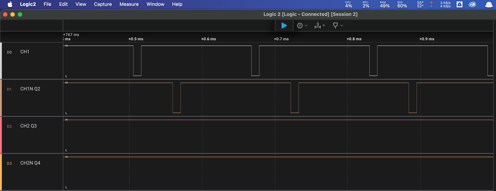

Hello , am using stm32f411 nucleo board.
uint32_t sin_table[2] = {
150, 250, 100}
HAL_TIM_PWM_Start_DMA(&htim1, TIM_CHANNEL_1, (uint32_t *)sin_table, 3)
HAL_TIM_PWM_Start_DMA(&htim1, TIM_CHANNEL_2, (uint32_t *)sin_table, 3);
I am giving this value to the ccr register
In PA8 and PA9 pin getting these PWM signal for the channel 1 and channel 2 corresspondily
but the square wave is not exact phase some phase shift why so ?
please help me ?
2024-07-22 10:48 AM
Probably because of the time it takes the HAL_TIM_PWM_Start_DMA() call to actually start the timer. If you want both timers to start at exactly the same time you need to configure them to start from a common trigger source. If you just need them "closer" but not exact, write your own "start" code that writes the final "enable" bit to the two times on two adjacent lines of code.
2024-07-22 11:23 AM
The result is bizarre in that the first channel runs to some form of effective disable (setting CCRx above ARR) before the second is started, and vice versa. Maybe consequence of declaring sin_table to have 2 elements and then use 3 for the DMA (i.e. it uses something "random" beyond the table).
I don't recommend trying to salvage the above code. To change both channels simultaneously by DMA, you should use the DMAR/DCR mechanism. It may be clickable in CubeMX, but I don't use Cube.
