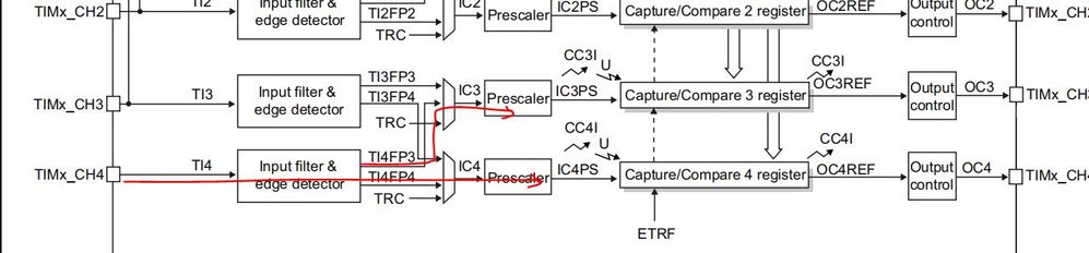

Since PA2 did a comparison output and could not be mapped to time2 ch3, then now only the red line can be captured for DMA control PA8 output. But TI4FP3 and TI4FP4 are all homologous, and there is no way to do a rising edge capture and a falling edge capture.
Thank you very much.

Yes there is. That's why TIM_CCER_CC4P is set, to invert the capture edge, i.e. capture on falling edge on CH4 only.
