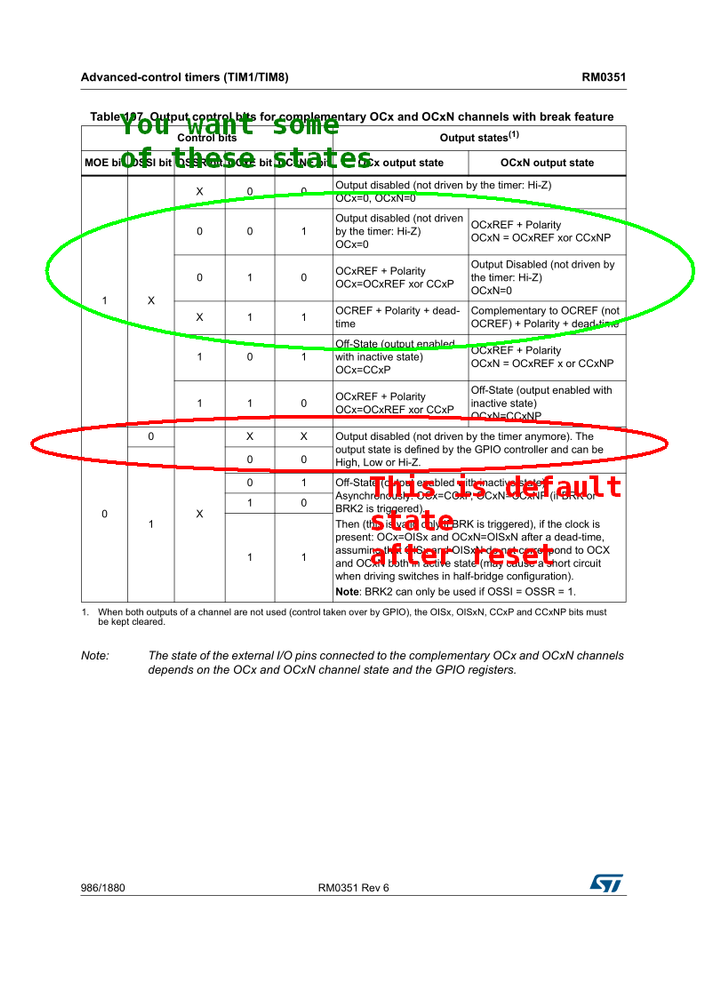

Read out and post content of relevant GPIO and TIM registers.
TIM1 is Advanced timer, did you set TIMx_BDTR.MOE?

Can you clarify TIMx_BDTR.MOE?
2019-11-02 8:38 AM
I was lazy to locate the RM for your particular chip, but the timers are much the same.
