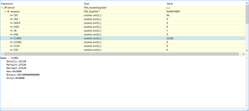

2018-02-15 4:19 AM
Like you can see in the image below, the CCMR1 register have the bit [14:12] set to 101 like required
in the datasheet.
2018-02-15 5:08 AM
What's the content of TIM21 registers (after the 'forcing' routine)?
Read them out in debugger and post.
2018-02-15 6:30 AM
Yes indeed, but also CCER is all zero which means the CCxE bits are cleared.
Try to set them.
