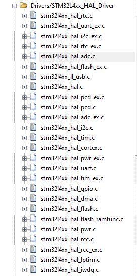

I have an application based on the STM32L4 device. When I started working on this application (I use Keil) I used Cube in order to setup the device according to my application. Please, look at attached picture where drivers folder in Keil is shown: drivers files refer to the files that were 'imported' to my project when I created it.
Since then, drivers may have some improvements or corrections so...

Clone the project into a new directory using your file manager. Copy in a fresh copy of the library includes and source.
Use a merge tool to update the projects hal_conf file, and then diff the two projects with same merge tool to understand scope of changes.
Might be better to root cause original failure first, but could also see if dynamics change with new libraries.
