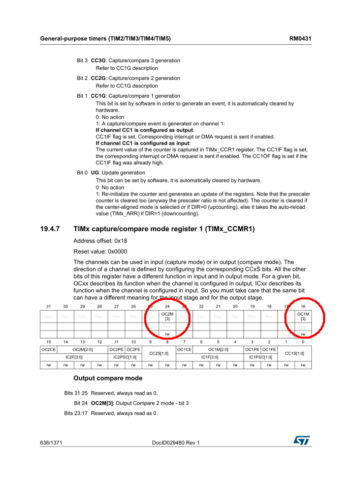

However, I noticed something remarkable in the manual. In chapter '19.4.7 TIMx capture/compare mode register 1 (TIMx_CCMR1)(x = 2 to 5)', 'Bits 6:4 OC1M: Output compare 1 mode.'
OC1M is a three bit field in the register diagram, however the options provided in this chapter for setting up this register all consist out of four bits. This doesn't make sense to me. Anyways, following the instructions from chapter '19.3.8 Output compare mode' I set OC1M to '011' to toggle on match.

This is for historical reasons. You write 0 to them so that's OK.
