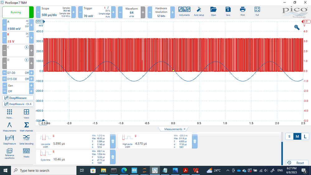

I am using HAL_TIM_PeriodElapsedCallback(TIM_HandleTypeDef *htim) to generate a sine wave based on DDS and I have also implemented ADC to get the value and perform some calculation. My sampling rate is 100KHz so my timer interrupt should trigger every 10us.
void HAL_TIM_PeriodElapsedCallback(TIM_HandleTypeDef *htim)
HAL_GPIO_WritePin(GPIOA, GPIO_PIN_6, GPIO_PIN_SET);
few codes calling dac and adc
HAL_GPIO_WritePin(GPIOA, GPIO_PIN_6, GPIO_PIN_RESET);
so the execution time is around 4.8us which means the callback function should wait till it reaches 10us and new trigger start if I understand it correctly.
But is it possible that the cycle time for one session exceeds 10us?
The high pulse width is fine, increases with increase in lines of code, but the low pulse width seems to not decrease beyond. This delays my timer interrupt trigger. What is actually happening behind this callback function?

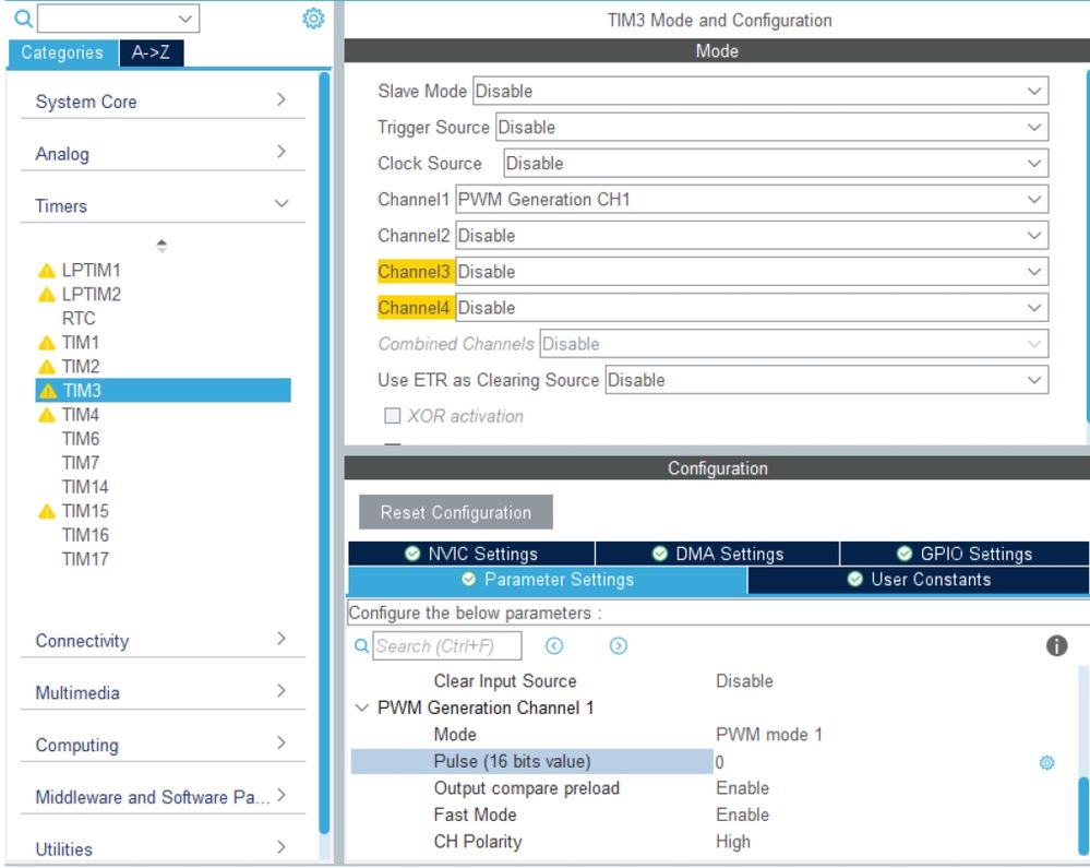

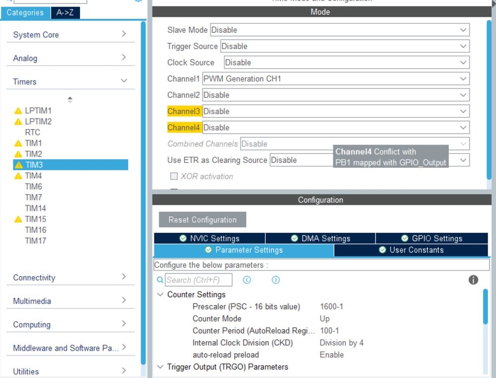

What's the TIM setting for PSC / ARR ? Remember these are N-1 values, ie last value before wrapping to zero.
Using ST's HAL with it's circuitous routing and call backs can add overhead of it's own.
Consider using DMA to feed pattern buffer values into ARR or CCRx registers at UPDATE

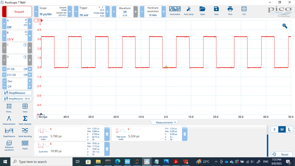

it's STM32-G071RB and I am using DDS technique to generate a sine wave. It's not the synchronization having the problem I assume. Just that the time taken for the code to be executed inside the timer interrupt is acting a bit weird. Even though the execution time is less than 10us which is the time period of my interrupt, it is delaying the interrupt. the question is why is my cycle time not fixed. This happened even when I was not using ADC.
