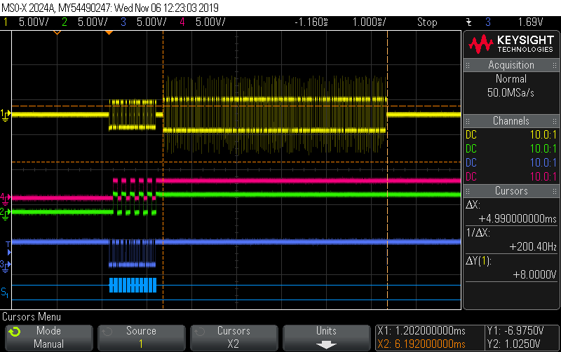

Problem is solved when I put termination resistors in the stard and end of the bus but when I do not do I have a strange behavior of the MCU that I cannot explain/understand.
Below you see the screenshot of Yellow: RS485 bus, Blue: The RX Line on the MCU.
This is a 115200 Baudrate, Even Parity, 1 Stop Bit, 8 bit communication.
All the bytes are translated correctly every time (10mil messages exchanged) BUT the very last one sometimes it is not interpreted correctly.

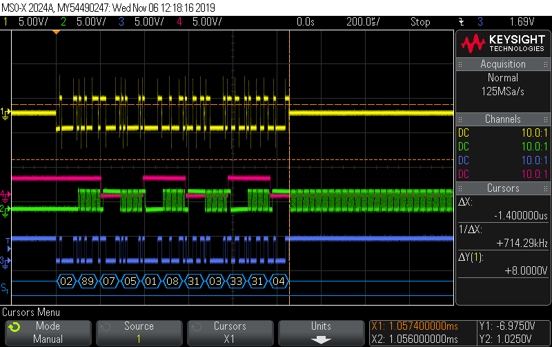

You see that the oscilloscope finds this message as 0x04 or 0b00100000.
The MCU finds it 0x82 or 0b01000001. I looks like shifted by one bit to the left, including its parity bit.
I consider that this is caused by the glitch at the end of the message.... but if you see this is after the stop bit! So I do not really understand this behavior...
I am not using DMA, this is a byte by byte reading, and a quick interrupt handler.
It is true that the overrun flag is triggered but I cannot really tell why..
This is when the last byte is not received properly
This is when the last byte is received properly.

However if you take a look on the two pictures I attached before it is clear that there is no drifting on the clock.
It is a rather BIG change on the last character, at least this is how I interpret it.
You see the consistency of the Green Signal that it toggles every time there is a new stop bit, for all except on the last character when the glitch is present.
If there was a drift I would expect that the whole Green Signal would have been slightly shifted but it only happens for the last character. I zoomed in, they always fall exactly on the same spot...

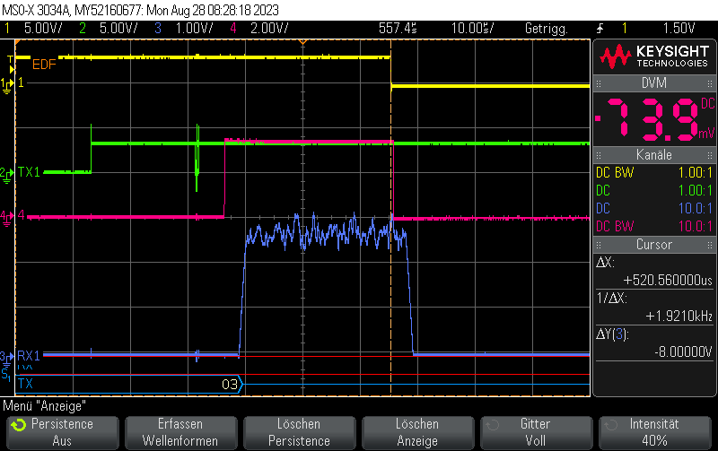

We have exactly the same problem here after we swapped the controller from F103 to L431 on a board. After investigating the problem more closely, we are very sure that it is a problem with the UART/USART peripheral. A short pulse during the stop bit often results in the last byte not being recognized correctly. As a solution for the problem, we change the UART configuration to 0.5 stop bits during reception and to the desired setting during transmission.
We have set up a project that reproduces exactly this error on a NUCLEO L476 board:

2023-09-21 9:51 AM - edited 2023-09-21 10:00 AM
We use DMA in our production code, which is where we first observed the behavior.
We do not use DMA in the project to find the error. In this troubleshooting project, exactly one UART frame is generated using a pattern generator. This one byte is always received. However, sometimes incorrect if the UART frame is disturbed with a glitch within the stop bit. This glitch is created using the pattern generator.
We looked at the generated pattern with the oscilloscope:
However, you can only see the signal around the stop bit.
Based on the investigations we have carried out, we are absolutely certain that there is a bug in the USART/UART Peripheral
