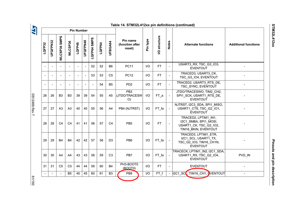

Maybe there's an error in the the 'L412 datasheet, the AF14 column for PB (and PC) compared to other 'L4 appears to be shifted down one position.
TIM16_CH1 appears to be at PB8 AF14. See also the pin definitions table.

I reread the manual from ST official website,the table show that PB9 alternate function AF14
I see that that's in the AF table; however, as I said above I believe this is an error, because

This is what I get from the device database XML files:
ethernut/nut/include/arch/cm3/stm/generated> grep TIM16_ stm32l41x_pinmux.h
#define TIM16_BKIN_FUNC 58
#define TIM16_CH1_FUNC 59
#define TIM16_CH1N_FUNC 60
((gpio == PA06) && (func == TIM16_CH1_FUNC )) ? 14 : \
((gpio == PB05) && (func == TIM16_BKIN_FUNC )) ? 14 : \
((gpio == PB06) && (func == TIM16_CH1N_FUNC )) ? 14 : \
((gpio == PB08) && (func == TIM16_CH1_FUNC )) ? 14 : \

i have try a 'l412board and confirm that PB8 alternate AF14

You are right, TIM16_CH1 should be at PB8 alternate function AF14 instead of PB9.
We will correct this typo in the coming release of the Datasheet.

Please note, that's not only PB8, but the whole PB and PC in column AF14 are shifted down by one cell.

Yes, well noted. Thank you Jan.
This is raised internally to the appropriate team for correction.
