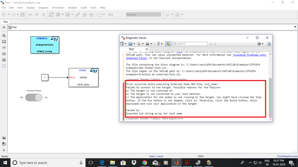

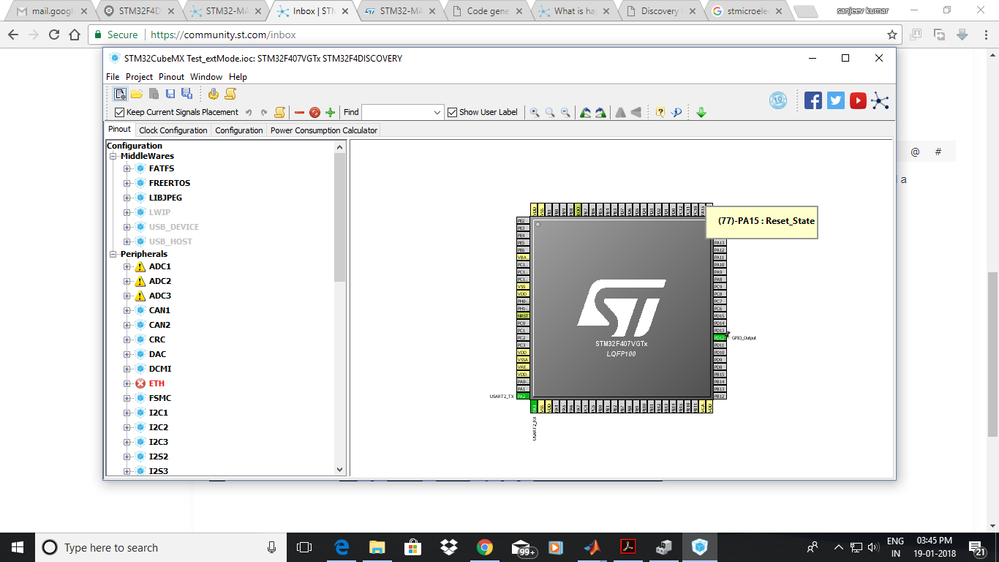

Here i attach the error am getting and i followed the step as per the manual. can u please suggest me what exactly happening. also please tell a configuration required for this. her i attached configuration of cubemx also. you help is more appreciated.
Thankyou
2018-01-19 4:33 AM
The error message gives you 3 possible causes for the problem - have you checked each one?
Please give full details.
