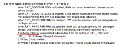

Hello @lozzz and welcome to the community,
This is what the reference manual of the product says for SWI bits in EXTI_SWIER register:
2024-12-12 8:03 AM
Hello, SofLit
Sorry I'am not seen !!
In that case, how can distinguish the software interrupt from external input in the EXTI handler ?
Regards
