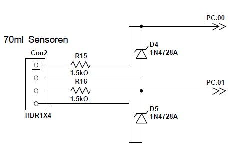

Both Interrupts are now working, but each Interrupt opens both IRQ Handlers. It's own first, and then the other one. Do I have something wrong with my board? Resistance between PC.0 and PC.1 is >0,7MOhm - so this should be OK. When I put a Voltage of 3V3 on PC.0 - PC.1 is under 0,05V and vice versa.Design is as followed:2014-10-28 12:15 PM
