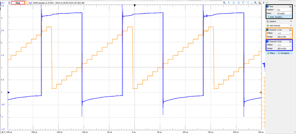

I can confirm @MBertocchi observations like when transferring a 16-step sawtooth using circular DMA:
orange is the DAC output, blue a GPIO/LED toggled in the interrupt.
The code is at register-level, no HAL involved:

KnarfB
2024-12-28 3:38 AM - edited 2024-12-28 3:45 AM
Hi @KnarfB ,
Thanks for the example.
This confirms what I wrote above: if the highest level is the last sample, DMA's Transfer Complete comes *one* trigger cycle before the last sample is output.
Non-triggered mode of DAC, and DMA triggered by timer rather than by DAC, can be used to achieve what @MBertocchi probably wants to achieve; or, if a signal/interrupt is desired one cycle after the last sample is output (at the falling edge of the above sawtooth signal), the output values table could be rearranged accordingly; or indirectly a timer interrupt could be used.
