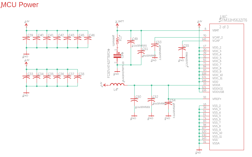

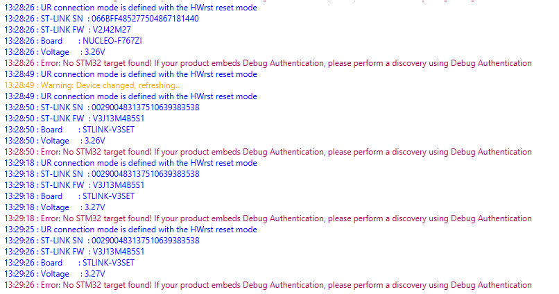

I got new prototypes (20 total) for a project with the STM32H562ZI and I'm not able to program/debug the MCU, can't detected the MCU, I try with ST-Link V2 and V3. I try ST-Link utilities, STM32CubreProgrammer and in STM32CubeIDE. I know that both programmer work because I can connect to another product.
I use SWD with PA13 (SWDIO) and PA14 (SWCLK).
I look all VDD for the 3.3V and they all fine, I check the VSS to be grounded and they are all good, the 2 VCAP pin give me 1.014V when I use BOOT0 at low and 1.213V when BOOT0 is high. Normally, I use the circuit with BOOT0 at low, but by looking this forums, some suggested to try BOOT0 at high, but that change nothing, I can't program.
I tried NRST with and without a pull-up, but I know that the MCU have one internal...
I would like your advice for the next thing to try or to check, I'm out of ideas.

MCU power
Programmer Message

Quadruple check pin assignments. Probe an unpopulated / solder-test board for expected continuity in power planes.
Orientation looks correct.

From your log, it looks like you also were unable to connect to a Nucleo-F767, is that correct? Might want to start with debugging that, and move on to custom hardware once a known good board is working.
Schematic and picture look okay to me.

I used the programmer on the Nucleo-F767 development module to try another programmer on my product, but encountered the same problem programming the STM32H562. Normally I use the STLINK-V3SET.
