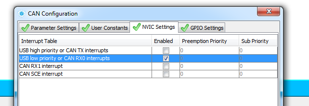

2018-08-11 7:25 AM
Thanks for your replies!
@TJ Did you used Stm32f103 for your Project?
Can you tell me how to set up for receive data using interrupt.
I debug buy ST-Link and see that: My stm32f103 received correctly data in RXFiFo, Over and full Flag are set. But Interrupt did not happen,
I set options for CAN_RX in CubeMX like that: (see figures)
and in my code, i set up as my attach files above
I think i have something wrong.
Can you check for me ?
thanks!
