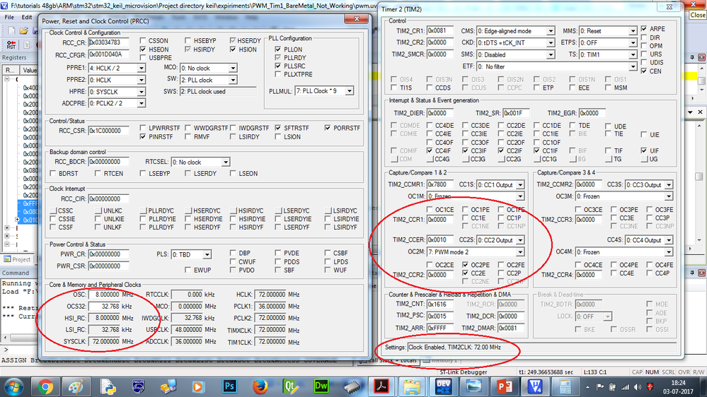

What I don't see in your code is the configuration of the MCU clock.
If you are mentioning about system core clock, it has already been set to 72 MHz inside the header file ''stm32f10x.h ''
The timer clock is also 72 MHz only because the clock branching to timer 2 from APB1 has a multiplier.
I could see that in the debug Window.

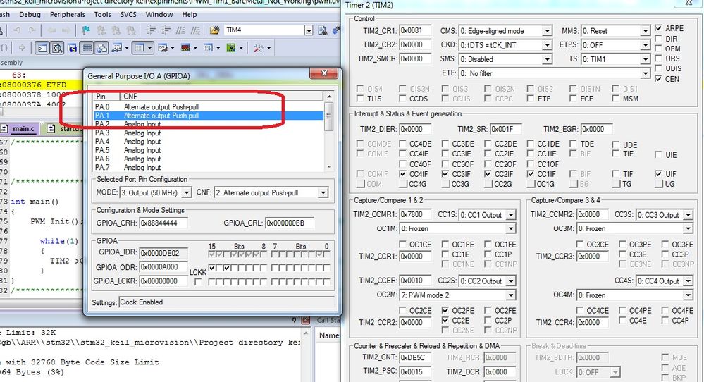

Also here is the view of the GPIOA peripheral block:
I couldn't find any clock setting mistakes.
I hate configuring clocks. It's too cryptic to get it right. Anyway I used the STM32Cub software to build your example and put a scope on it and it seems to work just fine.
Can you kindly mention about the GPIOA configuration ( selection of particular GPIOA 1 alternate function ).
