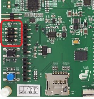

As clive has said, it is clearly a power problem.So can you please check that jumper JP1 is in position 2 (5V link) and LD2 is onJust to understand:Your board already is Mbed enabled (embed STLink V2-1) as shown in thishttps://yadi.sk/i/fblHZHiWmEfTm

Your original screen shot shows V2J25M13, do you have multiple ST-LINK attached to your machine? Remove everything except the STM32F7-DISCO board. Make sure it is jumpered to use power from the on-board ST-LINK.
I've pointed at the current update file, it contains multiple images for different ST-LINK variants, it will not let you flash the Stand-Alone ST-LINK with the mbed ST-LINK/V2-1 firmware, they use a different F103 part.2015-12-16 9:16 AM
