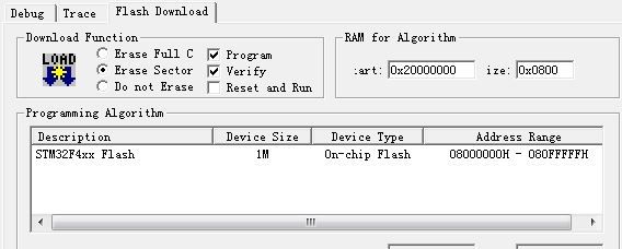

I have chose the STM32F405RG and the st-link debugger.
The program is used for STM32F407-DISCOVERY at first.It can work at the STM32F407-DICOVERY,but after I changed the device and other options.2013-08-22 4:13 AM

I was use the ''JTAG'' mode,and I'm sure that I have connected right in the light of the datasheet.
But both BOOT0 and BOOT1 connect nothing.May it is wrong here?One more question,when I use I2C,the voltage is up to 5V.And it have been connected to the pin-29 and pin-30.May I do like this?We’re moving the ST Community to a new platform to give you a better and more reliable community experience.
