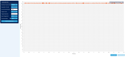

I'm running STM32C011F4U6TR using the LSI (32KHz) in a infinite loop.
Here's the current consumption I see from the STM32CubeMonitor-Power software
I expect to see around 80uA flat as datasheet shows at page 39
What could be the reason for the 170uA peaks I see using STM32CubeMonitor?
Gaston
2024-07-23 7:48 AM
Solved! I've disconnected the debug probe and run the code without SWD interface. Now it's working as expected
Thank you,
Gaston

@Gaston wrote:I'm running STM32C011F4U6TR using the LSI (32KHz) in a infinite loop.
At these levels, current consumed by the rest of the hardware can easily be significant - even things like capacitor leakage.
Show the code, and details of the hardware:
2024-07-23 6:20 AM
Also the table specifies that the typical values are expected at 3.0V supply, when you are supplying 3.3V to your uC.
As @Andrew Neil said, any other enabled stuff can contribute. Have you disabled HSI ? Please show us the used source code.
Best regards.
2024-07-23 7:48 AM
Thank you,
Gaston
2024-07-23 8:29 AM
Yes, having a debug probe connected will certainly affect the current consumption!!
