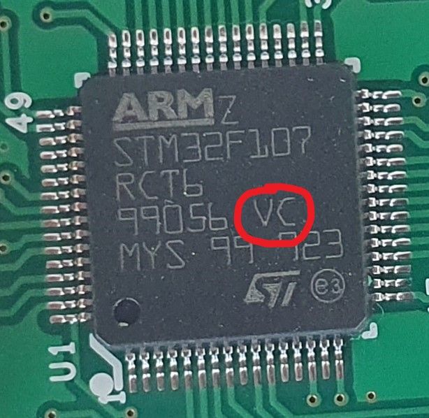

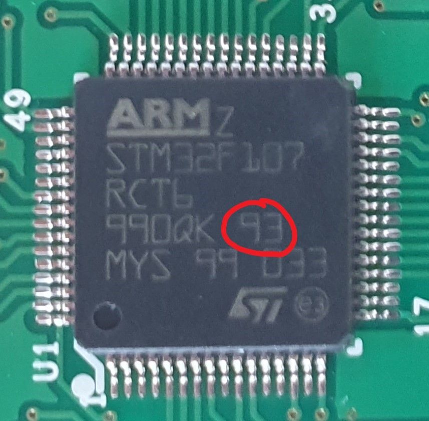

When it is 93, it works normally, but when it is VC, it does not enter uart boot mode.
What's the difference?

It's where the wafer's were diffused, so maskset also.
Do you pull BOOT0 LOW in your design?
93 TSMC Taiwan Fab 3
Not familiar with VC, perhaps Crolles or one of the French plants, PCN not helpful

yes i pull BOOT0 LOW in my design.

Could someone confirm if this is ST product? I don't find any reference to the VC fab code, or any related PCN. Can't say I've done a exhaustive search, but enough that something should have shaken loose.
Shouldn't you be pulling BOOT0 *high* to enter bootloader?
And, also, BOOT1 low.
