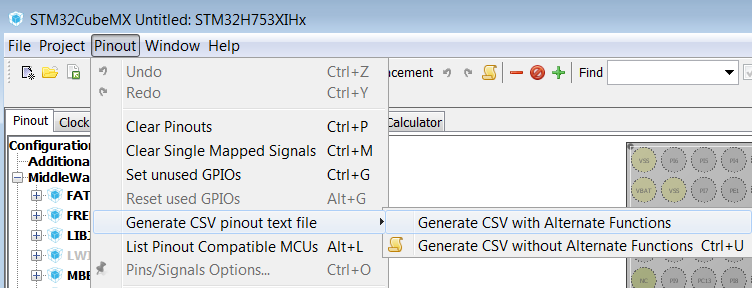

Otherwise, you should be able to have this multiplexing in a .csv file that you get using STM32CubeMX:
  1. Open a new project to use STM32H753XI device you select from the STM32CubeMX interface
  2. Go to ''Pinout'' tab, and then select ''Generate CSV pinout text file'' as following:
