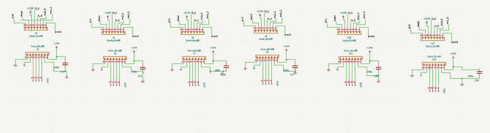

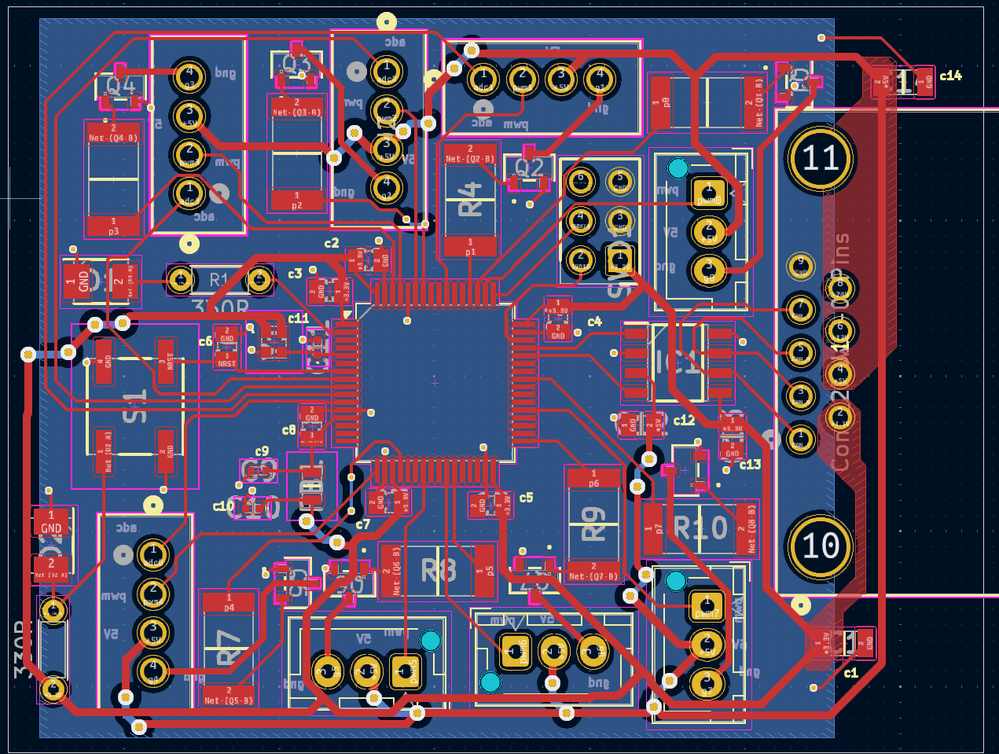

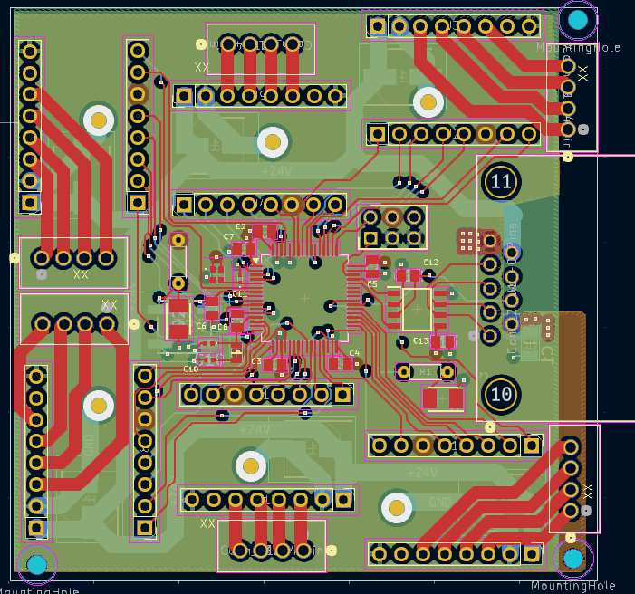

Hello, I am creating 2 pcbs, one for controlling 6 stepper motor drive boards, and one for controlling 8 servos. Both have an STM32 and CAN communication. It would be great if you could critique my designs and tell me where I could improve so they have the maximum chance of working

There are many things where poor layout could make the design a failure.
  • When switching high-current and particularly inductive loads (such as stepper motors), what path the current takes, and how you contain the turn-off spike.
  • How far spiky current-use (including the microcontroller itself) is from the voltage-regulation and power-supply-decoupling.
  • How tight any crystal oscillator loops are, and how well-isolated they are from interference.
  • How good your separation is between anything analog and noisy digital signals (including the microcontroller itself).
  • How you isolate noisy off-pcb signalling such as CAN from the microcontroller.

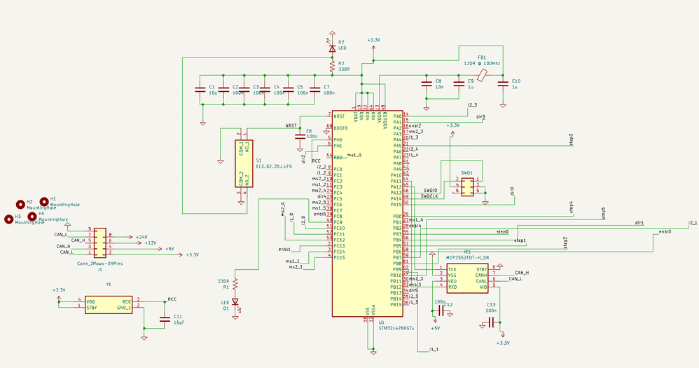

But without access to the schematic, it's largely guesswork. What is your chosen stm32? Help us to help you by posting both schematics, including component-values and capacitor-dielectric choices.

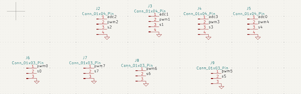

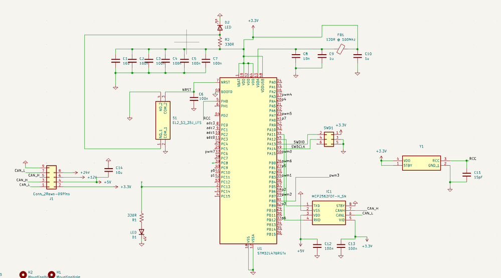

stepper schematicstepper schematicheaders for driver boardheaders for driver boardservo schematicservo schematicheaders to connect servosheaders to connect servospower controlpower control

Two things are clear that I don't like:
Different pin-outs for your SWD1 connectors. That's just asking for trouble. (I tend to use the TC2030 as it means I don't have to mount anything on my pcb and there is an "official" pinout I can stick to. Those connector are expensive so maybe a hobbyist can't justify them.)

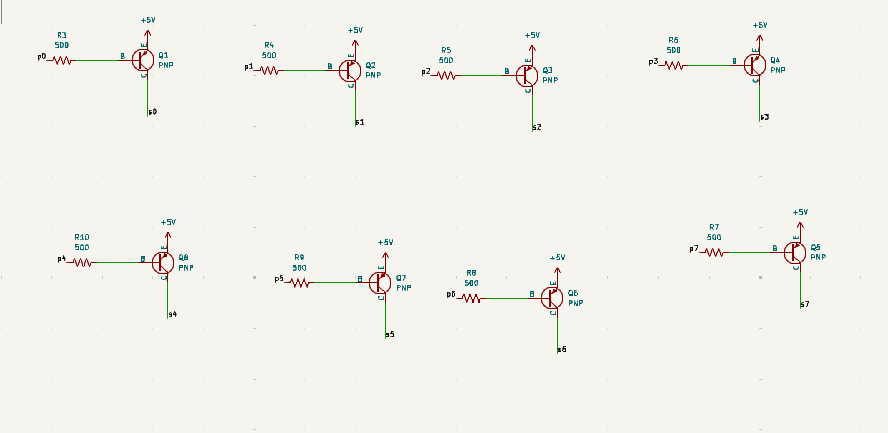

Your pnp transistors Q1 to Q8: The emitters claim to be at +5V but the stm32 output will only swing to Vdd i.e. 3.3V. So the transistors will never properly be turned off. (You might get away with it by driving them open-drain, but in the absence of any resistor between base and emitter turn-off could be slow).

Thank you so much for the reply, I realized that the transistor thing may be an issue and have been looking into ways to rework the design. Apart from that, what are your thoughts on how the PCB is laid out? Decoupling Capacitors, Clock placement, PWM signals, etc? Im fairly new at this and am designing it for a club, so I havent really had the chance to progressively work my way up to complex PCBs so any advice would be a huge help.

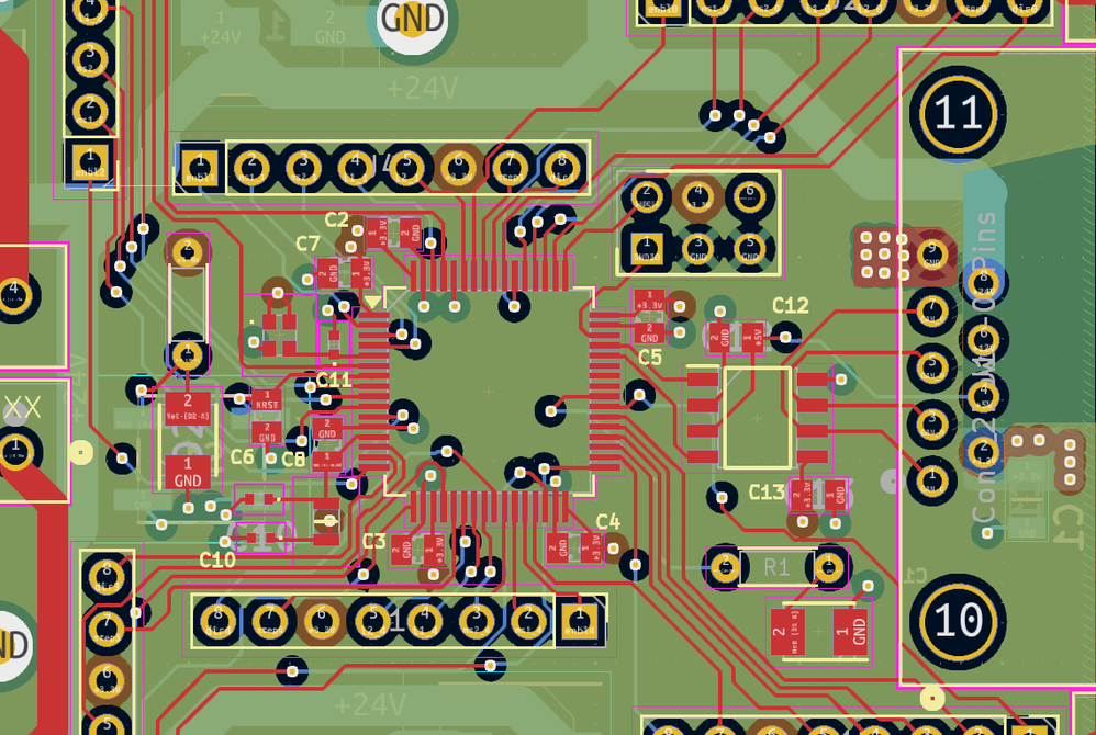

How do you propose to mount the boards? Quite often we'll have 3mm diameter holes at each corner. It stops things flapping around and potentially shorting out.
I don't like that you don't have voltage-regulation for the stm32 on-board.
On the stepper-motor board, you have very thick wires between the 16-pin modules and the 4-pin stepper motors. But I don't see the +24V distribution being much thicker. And more-importantly, I don't see the 0V return for the stepper-motors being separate from the stm32's 0V.
Is it a 4-layer board? 2oz copper?
Do you propose to hand-solder the through-hole components? If so, I'd make the pad rings-of-copper rather thicker to allow the heat of your soldering-iron tip to get to the metal particularly on the 4-pin servo connectors.

Is voltage regulation necessary if the board receives power from a stable buck converter.
In terms of wire thickness, only one stepper motor will be on at once.
For the 0v, is this a huge issue, the 24V and 3.3v share a common ground at the supply, so can't they both connect to the ground plane. If not, where should the 0V of the stepper motors go?
The stepper motor board is 4 layers, the servo one is 2

In general:
  • do not think of "GND" / 0V as the magic zero-impedance return path, it is never
  • keep all switched signals as short as possible, that's even more important for switched high currents - and don't forget the GND/0V return path (e.g. for a switching regulator, you might want to keep the GND pin of the input and output capacitors closely together (depending on the topology maybe also the regulator's GND pin))
  • I always prefer to decouple each IC's voltage supply with a ferrite bead (or 0R or small resistor, depending on load), that way you can better control the current flow
Even crappy designs might work with disregarding the above - but then it will surely never pass the EMI testing...
