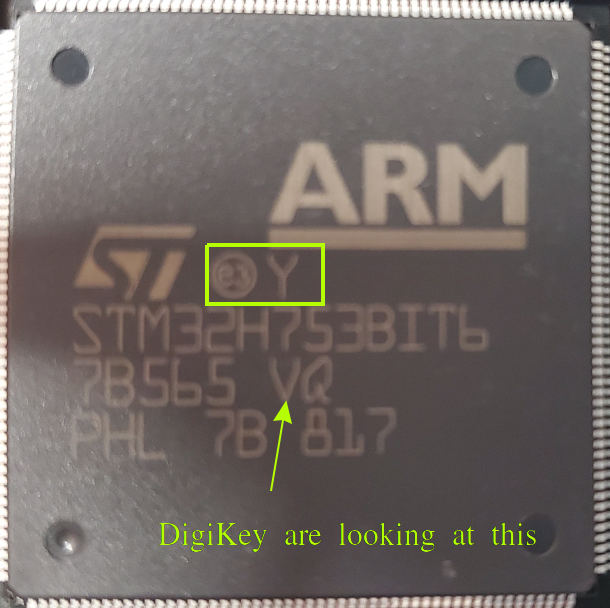

DigiKey initially said that they have Rev V but see the below photo they sent from stock and we marked it for them, as per the datasheet this IC is Rev Y, DigiKey are looking at the bottom V which stands for something else. After we pointed this to DigiKey, they came back and said that yes its Rev Y and there was some confusion and cant order Rev V parts. But the problem now is that no supplier can supply Rev V, so basically we have no place to order Rev V parts.

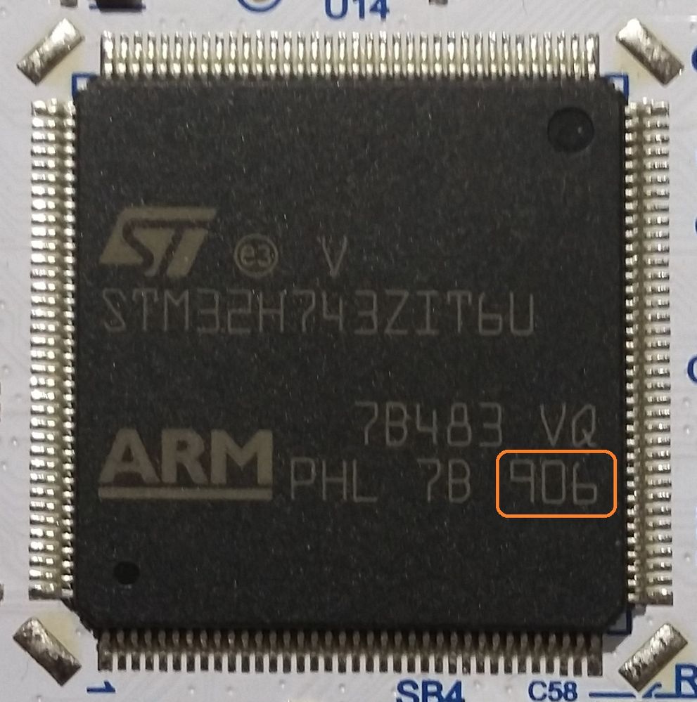

Here 2019 Week 6

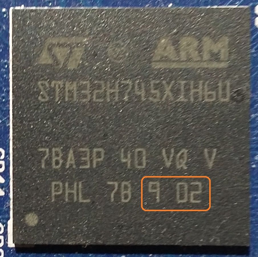

STM32H745XIH6U 2019 Week 2
