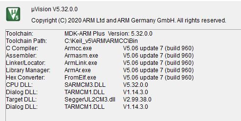

Can you please show on the debugger how are packed on memory sz ?
Here is how it works for ARM/Keil for adding padding or not for each variable inside the structure? By default it should be 8 packed .
May be also to know the optimization level used as well , so we can discuss with Keil colleagues .
