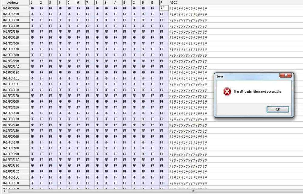

i have an problem with the OTP Programming. I use an STM32F429 and ST-Link/V2 with the Software STM32 ST-Link Utility V3.9.0. The OTP Bytes started at 0x1FF0F000. I see the content of this Bytes (0xFF) with blue background color. I try to change one of the Bytes in 0x7F. But it doesnt't work. I become the following error message:2016-07-26 2:18 AM

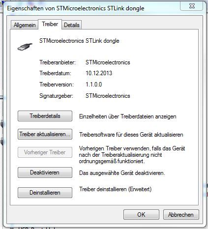

Try to upgrade the ST-Link firwmare to the V2-1 version through ST-Link utility or this Link and tell me if that solve the issue. -Hannibal-2016-08-02 2:18 AM
Hi Hannibal,

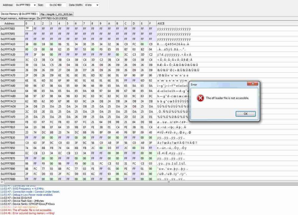

many thanks for the answer. But it does still not work. Here the error message2016-08-09 9:57 PM
the OTP Programming does not work with theST-Link Utility Version 3.9. With 3.8 Version it works.
ByKai Paulus2016-08-10 2:11 AM
Hi kai.paulus,
We confirm the issue ad will be fixed in the next release. Sorry for the inconvenience. -Hannibal-We’re moving the ST Community to a new platform to give you a better and more reliable community experience.
