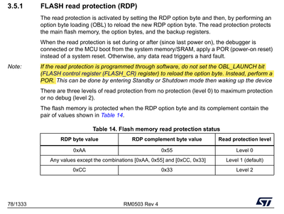

2025-08-02 3:49 PM
I agree with your assessment of what's happening. Although it's not documented, so we're guessing here.
Here's the relevant RM section:
2025-08-02 2:37 PM
The reference manual says to do a POR rather than launching option bytes if you set RDP through software.
Erasing and writing to flash (where option bytes are stored) takes some time, probably in the tens of ms range. How is IWDG configured that it's resetting so quickly?
You could also try reloading it in the while (true) look after launching option bytes. Unsure if that'll do anything.

2025-08-02 3:49 PM
2025-08-02 4:00 PM
Makes sense. I wish they had put that in my manual for stm32g071. Would have saved me days?
