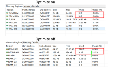

2023-12-03 10:48 PM
why the usage of RAM changed after optimize on?see picture below.

2023-12-04 6:21 AM
Perhaps the optimizer keeps things in registers, or constant data in FLASH ?
If it's important, review the generated code/data. Start with the map and listing files.
