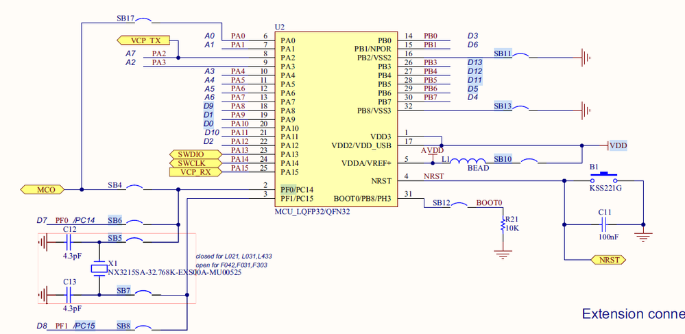

2023-04-25 5:29 AM
Just look at the schematic. PA2 is connected to STLink VCOM TX, PA14 is SWCLK. You cannot reasonably use these pins without changing board configuration (solder bridges).
2023-04-25 5:38 AM
Hello i have removed the SB2 connection to sever the PA2 pin from the VCP_TX pin before testing the code. And i am getting UART output. The serial output stops when the Interrupt is triggered
