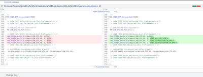

Hello @Kannan1,
Thank you for having reported this.
Our team is very aware of this issue and an Internal ticket number 171673 is submitted to fix the max packet size:
HAL_PCDEx_SetRxFiFo(&hpcd_USB_OTG_HS, 0x200);
HAL_PCDEx_SetTxFiFo(&hpcd_USB_OTG_HS, 0, USBD_MAX_EP0_SIZE/4);
HAL_PCDEx_SetTxFiFo(&hpcd_USB_OTG_HS, 1, USBD_CDCACM_EPIN_HS_MPS/4);
HAL_PCDEx_SetTxFiFo(&hpcd_USB_OTG_HS, 2, USBD_CDCACM_EPINCMD_HS_MPS/4);

@Imen.D Thank you very much for the quick reply. Everything works fine by increasing the size of tx fifo 1, which is the BULK Endpoint IN for CDC-ACM. Now I can work with a larger Pkt size of 2048 in my code.
#define MAX_PKT_SIZE 2048Between, Why you have divided the max pkt size of EPIN_HS (which is 512 bytes maximum for HS) by 4
HAL_PCDEx_SetTxFiFo(&hpcd_USB_OTG_HS, 1, USBD_CDCACM_EPIN_HS_MPS/4);Could you explain it please? Also what should be the optimum size of this FIFO for maximum throughput?

As @Imen.D suggested, I have kept the total Tx fifo size to 2048 bytes.
HAL_PCDEx_SetTxFiFo(&hpcd_USB_OTG_HS, 1, /*USBD_CDCACM_EPIN_HS_MPS/4*/2030);
HAL_PCDEx_SetTxFiFo(&hpcd_USB_OTG_HS, 2, USBD_CDCACM_EPINCMD_HS_MPS/4);I think the maximum packet size sending for FS configuration is the 64 bytes and for HS is 512 bytes. I was able to execute the function ux_device_class_cdc_acm_write with max size of 2048 bytes as requested_length. So internally this API will fragment the 2048 bytes to 4*512 bytes and send it.
