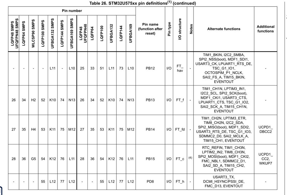

Hello everybody! Just wanted to clarify. I have still been playing with the TIM1 module. The datasheet for STM32U575ZI states that pin's PB13 alternate function TIM1_CH1N - is the first in the list, thus its number is zero. Yet, the TIM1_CH1N signal goes out only when I write "1" into the corresponding field in GPIOB AFRH register, which means that in reality TIM1_CH1N signal is actually the alternate function no.1, not zero. Does it meant that the datasheet is incorrect, or I simply misunderstand something?

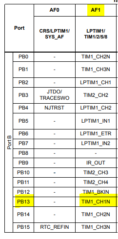

Oh! It seems that I have been using either a different datasheet, or look at a different page as I don't have such a table. Could you please let me know the file and the page, where I can find this table? Please!!
I only have this:
Sarra.S
Hello again @Skfir​,
it's in paragraph 4.3 Alternate functions, table27 alternate functions AF0 to AF7 in stm32U575xx datasheet rev7
Found! Thank you so much, Sarra!​
