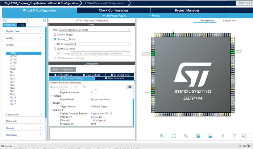

For the Nucleo-575ZI-Q, while in stop mode 2, I have the capture module enabled, I set CH1 IO Usage as input.

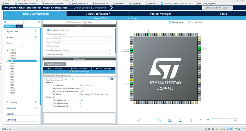

I made a very short project isolating the problem, the RTC is used to exit stop mode 2 every second, when waking up only CRR1 is read and returns to stop mode 2.

static void MX_LPTIM1_Init(void)
  /* USER CODE BEGIN LPTIM1_Init 0 */
  /* USER CODE END LPTIM1_Init 0 */
  LPTIM_IC_ConfigTypeDef sConfig = {0};
  /* USER CODE BEGIN LPTIM1_Init 1 */
  /* USER CODE END LPTIM1_Init 1 */
  hlptim1.Instance = LPTIM1;
  hlptim1.Init.Clock.Source = LPTIM_CLOCKSOURCE_APBCLOCK_LPOSC;
  hlptim1.Init.Clock.Prescaler = LPTIM_PRESCALER_DIV1;
  hlptim1.Init.Trigger.Source = LPTIM_TRIGSOURCE_SOFTWARE;
  hlptim1.Init.Period = 65535;
  hlptim1.Init.UpdateMode = LPTIM_UPDATE_IMMEDIATE;
  hlptim1.Init.CounterSource = LPTIM_COUNTERSOURCE_INTERNAL;
  hlptim1.Init.Input1Source = LPTIM_INPUT1SOURCE_GPIO;
  hlptim1.Init.Input2Source = LPTIM_INPUT2SOURCE_GPIO;
  hlptim1.Init.RepetitionCounter = 0;
  if (HAL_LPTIM_Init(&hlptim1) != HAL_OK)
    Error_Handler();
  sConfig.ICInputSource = LPTIM_IC1SOURCE_GPIO;
  sConfig.ICPrescaler = LPTIM_ICPSC_DIV1;
  sConfig.ICPolarity = LPTIM_ICPOLARITY_RISING;
  sConfig.ICFilter = LPTIM_ICFLT_CLOCK_DIV1;
  if (HAL_LPTIM_IC_ConfigChannel(&hlptim1, &sConfig, LPTIM_CHANNEL_1) != HAL_OK)
    Error_Handler();

  /** Enable the WakeUp
  if (HAL_RTCEx_SetWakeUpTimer_IT(&hrtc, 0, RTC_WAKEUPCLOCK_CK_SPRE_16BITS, 0) != HAL_OK)
    Error_Handler();

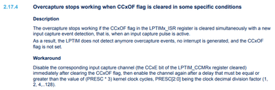

Imen.D
Hello @dhs,
Did you check the STM32U575 errata sheet in LPTIM section ?
Maybe you have the same condition here:

Hello @Imen.D
Yes, I saw it and I followed the workaround, but the problem persist.
