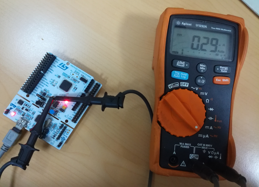

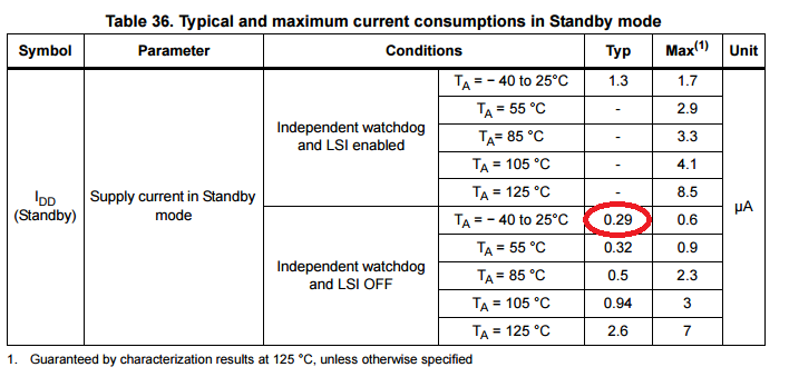

2017-01-27 6:01 AM
Hello everyone,
Please refer to the ''PWR_STANDBY'' example provided when downloading the
package:STM32Cube_FW_L0_V1.8.0\Projects\STM32L053R8-Nucleo\Examples\PWR\PWR_STANDBYThe Idd=0.29µA; which is with the same as the value on the datasheet.
Khouloud
