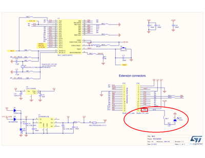

LED on the Nucleo32 is at PB3, not at PB13 (PB13 is not available at the 32-pin package at all).

Oh no! I feel really dumb. I looked at the nucleo32 board description and mixed up the Arduino nano pin description (D13) with the stm32 pin (pb3). I’m not at my desk right now, so can’t try immediately.
