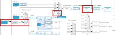

Hello @KT_Matt ,
I would suggest these timings @500kb/s for FDCAN in classic mode/ MCU running at 400MHz with an extarnal precise crystal (in your case 8MHz using STLINK MCO in Bypass mode):
I've attached the updated ioc file.
Hope it helps.

Hello @KT_Matt ,
Hope it helps.

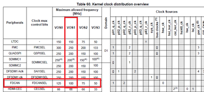

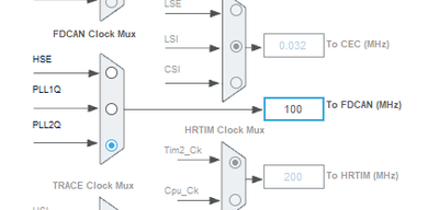

2024-11-18 1:52 AM
Hi @mƎALLEm ,
I tried the recommended configuration. Looks like the FDCAN is not working with this clock speed(100Mhz). It works only with 48MHz.
2024-11-18 1:59 AM
Hello @KT_Matt ,
It should work at 100MHz / System clock at 400MHz/VOS1:
Did you try Loopback mode first? Try External Loopback mode and probe with an oscilloscope or analyzer on FDCAN_Tx pin. Do you receive the sent frame?
