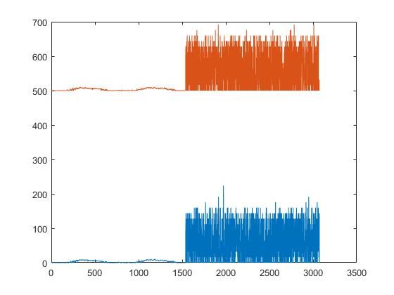

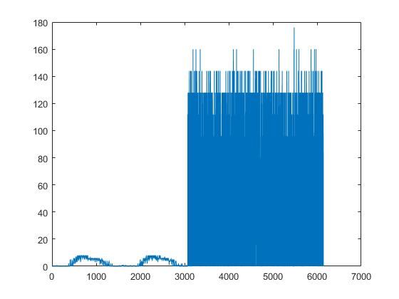

I tied the ADC in to GND, make the ADC DMA work normal mode, what ever I change the transfer size, the nois is big different just in the middle.
Crazzy!!!2016-10-06 10:17 PM
This is two ADC's sepreat display.

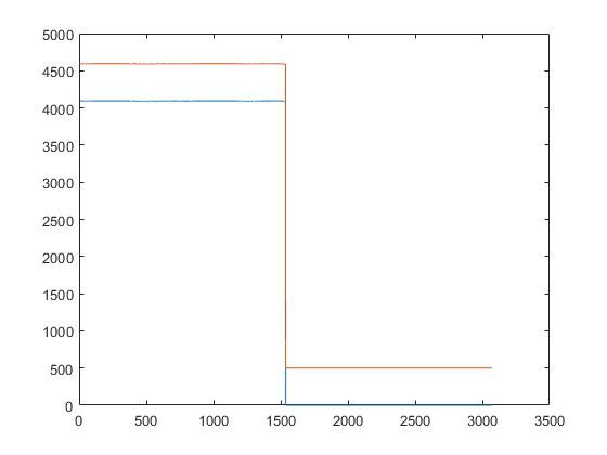

I think the problem reason is the DMA config, need some times to understand! Tie ADC1 to VCC, ADC2 to GND, and memset all data to 0, now the figure is:2016-10-10 9:29 AM
Hi qiyong.mu.001,
The noise may come from spurious charge shots out of AD inputs. Try to eliminate that with the using of ''Averaging'' or ''Digital-signal filtering'' methods described in the application note ''How to get the best ADC accuracy in STM32Fx Series and STM32L1 Series devices'' (page 22 and page 32)-Hannibal-We’re moving the ST Community to a new platform to give you a better and more reliable community experience.
