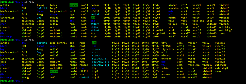

Hi, I've been working with the NUCLEO-F401RE board developing on windows. Everything has been going smoothly but I'm having issues now that I'm trying to connect it to a Raspberry Pi.
On Windows, when connected, the STLink Virtual COM port shows up properly, which I use to provide serial communication between the host and the board.
However on the Raspberry PI, there is no COM port showing up (tty).
The following is the output of "dmesg" after connecting the board, followed by the output of "ls /dev" The new items that are showing are: sda, stlinkv2-1_, stlinkv2-1_0, stlinkv2-1_1
However none of those seem usable as serial communication. Does anyone have any insight of what I may be doing wrong, or something I've missed that I need to solve this?
Any solution or guidance as to where I might start looking would be appreciated
