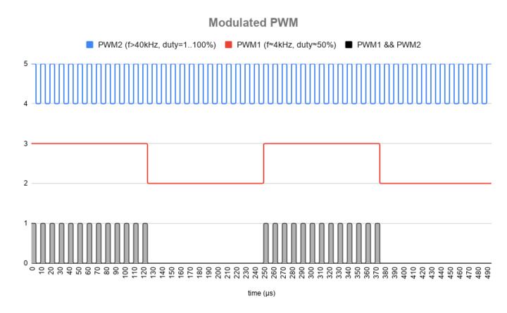

2023-06-04 11:35 PM - edited 2023-11-20 4:21 AM
What i came across is that to generate the wave form (as similar to question - just a single wave form as per image) We need two pwm which can be logically & to get the resultant out put.
Is that true?
Is there any other way to do it without using any addon timer. Like combine pwm output?
I came across post where something similar is required. I need help to understand the same. Putting refrence link and image.
Link
https://community.st.com/s/feed/0D50X0000C4PPGhSQO
Image is just for reference and not represent exact requirements of frequency and duty cycle.

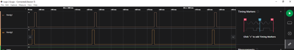

2023-06-05 10:48 AM - edited 2023-11-20 4:21 AM
@HA.5 I tried and I am able to produce the output. Sorry If I asked or may ask a stupid question since I am unfamiliar with this controller.
Here are the results.
